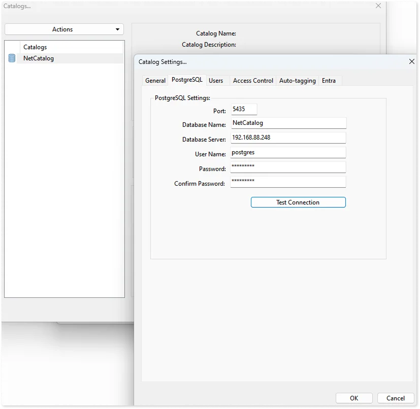

Daminion Server configuration
Now, in the catalog configuration, you need to specify your PostgreSQL server.
To do this, open Daminion Server Administration Panel -> Catalog Settings:
Change “databaseServer=”localhost”” to “databaseServer=”the IP address of your PostgreSQL server”” in each catalog.
If a non-standard port was used on the server or if the login and password were changed, you should also update them.
You should do this for all of your current catalogs. After that, close the сatalogs settings window and restart Daminion Server.
