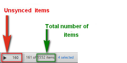

To check the number of unsynced items, navigate to the bottom left of the Status Bar. The number of unsynced items is shown on the left followed by the number of items displayed, the total number of items in the catalog, and the number of items currently selected. In our example, 160 of a total of 1,552 items are not synchronized.

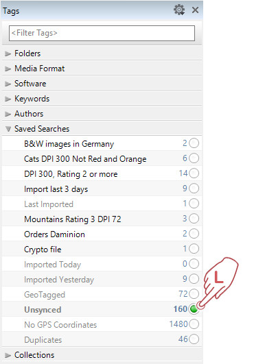

Synchronization status can also be checked on the Tags panel under the Saved searches tab. If Saved Searches is not displayed in your catalog, click the little gear icon on the Tags panel header bar, select Customize and then check Saved Searches. Under the Saved Searches tab, check the Unsynced tag. If you want to view all unsynced items in the Browser window, click the little empty circle to the right of Unsynced.

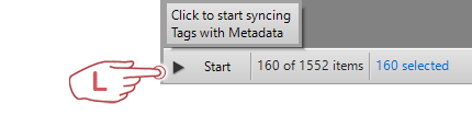

If you don’t want auto-synchronization to be permanently active and load your network, you can run it manually when required. To do this, navigate to the bottom left corner of the Status bar and click the little triangle next to Start.
When starting manually, make sure you deactivate auto-synchronization again in the top right corner of the browser area, once the items are synced.
