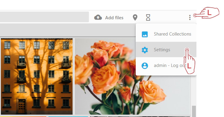

To activate Required metadata, log into your catalog as an administrator, click the three dots icon in the upper right corner of the web client interface, and select Settings.

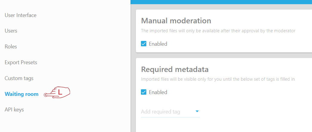

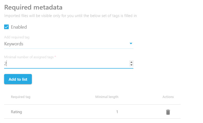

In the window that opens, click Waiting room, then enable the option Required metadata and click the dropdown menu to Add required tag. Here you can also activate Manual moderation.
In the Required metadata menu, click the down arrow to expand the list of available metadata fields that can be added as required tags.

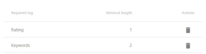

In our case, we have selected Rating and Keywords as required tags. If the tag allows multiple values to be assigned to files, an additional “Minimal number of tags” entry will be shown.
If the selected tag is a long text tag that allows only one tag value to be assigned to the files (for example, Event, Project, Comment), specify the minimum number of characters the tags can contain.
The screenshot below shows that 1 rating and at least 2 keywords should be assigned to the imported files.

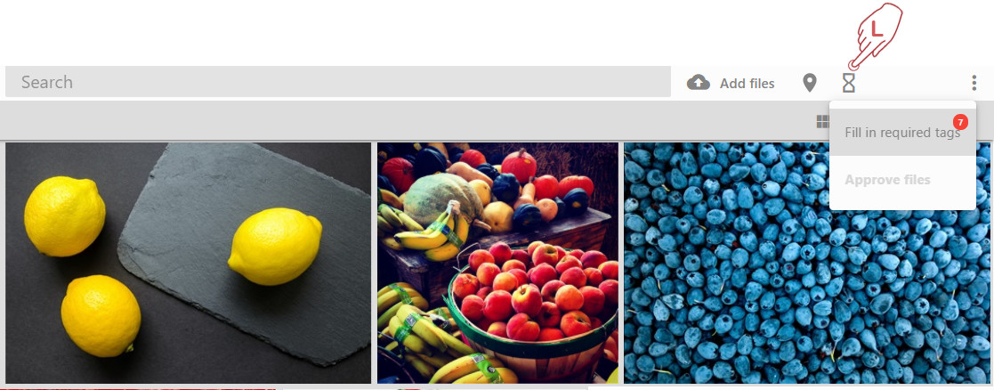

On the toolbar, click the hourglass icon to open the Required metadata area. Please note that only the images imported after the activation of the Required metadata option will get into this area.

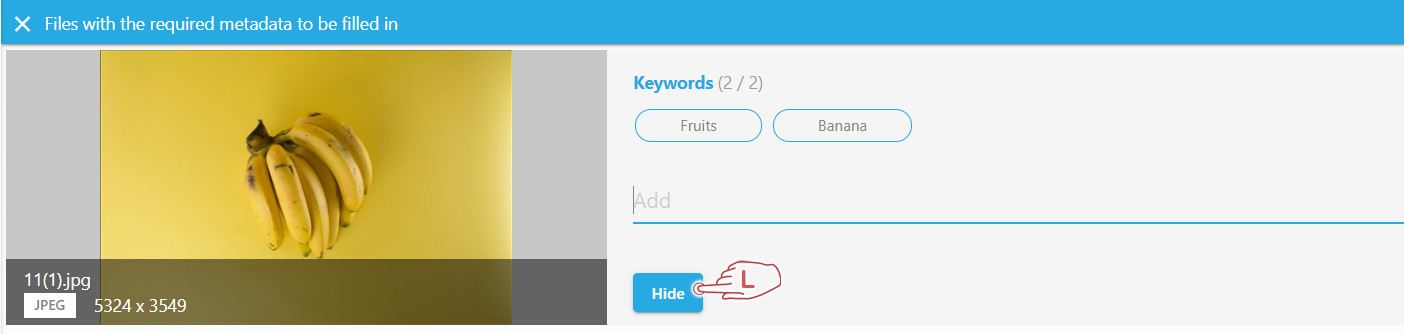

In the window that opens, start tagging your files. Once the tagging is complete according to the Required metadata settings, the Hide button will appear.  In our case the settings were one Rating and two Keywords.
Click the Hide button to remove the images the Required metadata area.

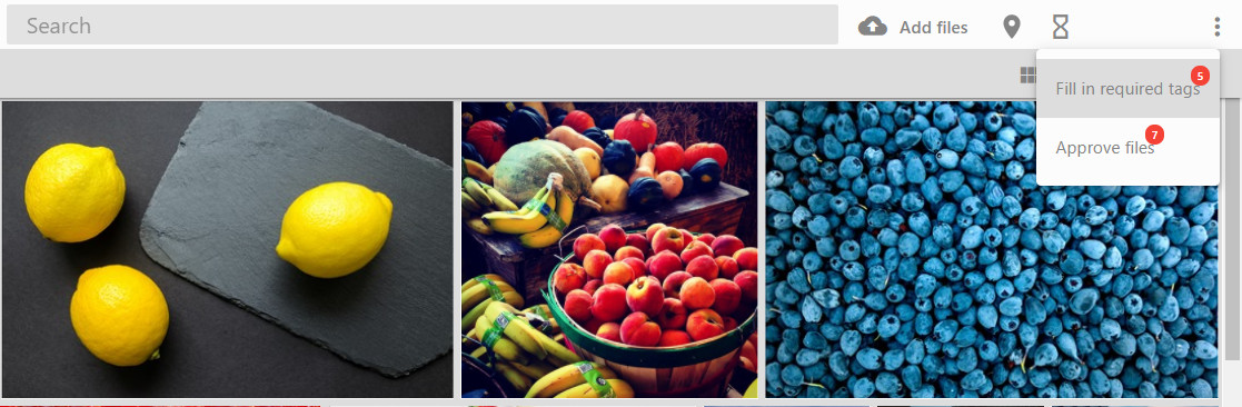

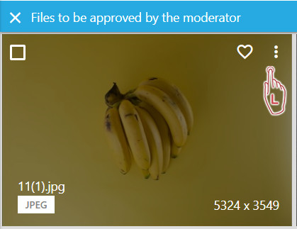

To access the Manual Moderation area, log in as admin and click the hourglass icon. Two options are available there: Fill in Required Tags and Approve Files
Click “Approve files” and in the window that opens, hover your mouse over a file that needs to be approved. Click the three dots icon and select “Approve”. You can select and approve multiple files at the same time.
If a file lacks required metadata, you will have an option to approve it anyway if needed and make it available in the catalog for other users.
