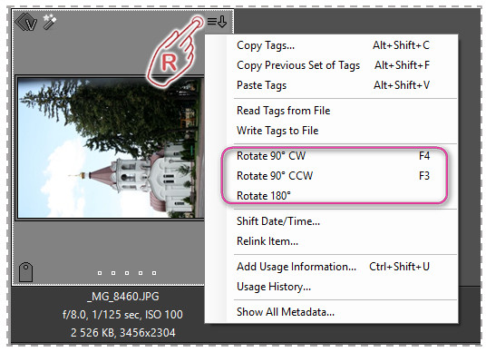

To change thumbnail orientation, select one or multiple thumbnails in the Browser window, click the arrow icon in the upper right corner of any thumbnail and select the desired rotation.
Alternatively, you can rotate thumbnails with the following keys:
[F3] key – to rotate counterclockwise
[F4] key – to rotate clockwise
