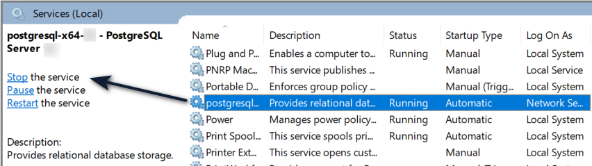

  5. Stop your current PostgreSQL in Windows Services.

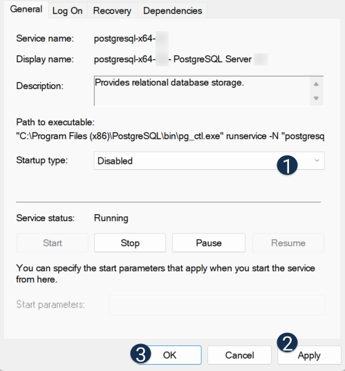

  6. Set your current  PostgreSQL to disabled by right-clicking it and selecting “Properties”, but do not uninstall it and do not delete its Data directory yet.

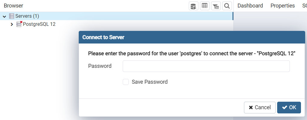

  1. Click on the Windows Start button located at the bottom left corner of the screen.
  2. Type “pgAdmin” in the search bar. As you type, the search results will start appearing.
  3. Locate the pgAdmin application in the search results. It is usually displayed as “pgAdmin” or “pgAdmin 4.”
  4. Click on the pgAdmin application to open it.

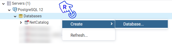

  5. Connect to the Servers and expand PostgreSQL12
  6. Right-click on “Databases” and select “Create” > “Database”.
  7. In the “Name” field, enter “_daminion” (without the quotes).
  8. Click “Save” to create the database.

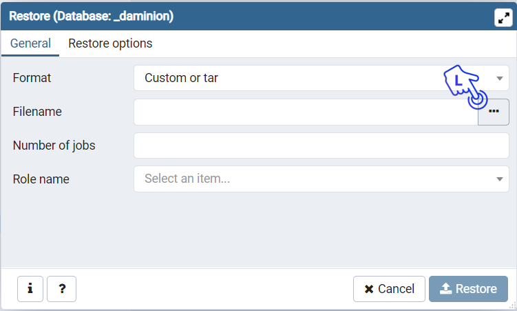

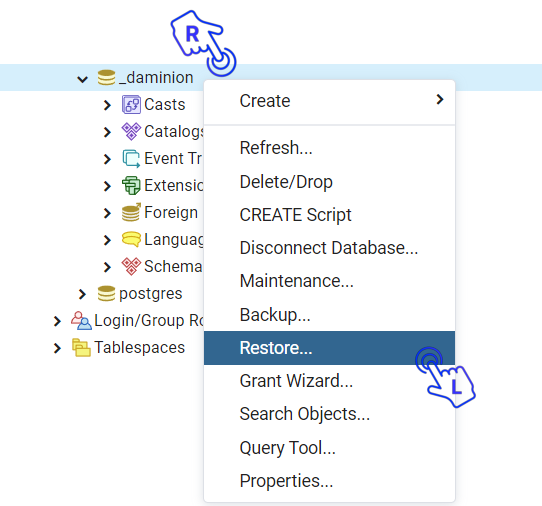

  9. Right-click on the newly created “_daminion” database and select “Restore.”
  10. In the “Filename” field, browse to the location of the backup file you want to restore.
  11. Select the backup file (“_daminion_DATE_TIME.backup“) and click “Restore.”

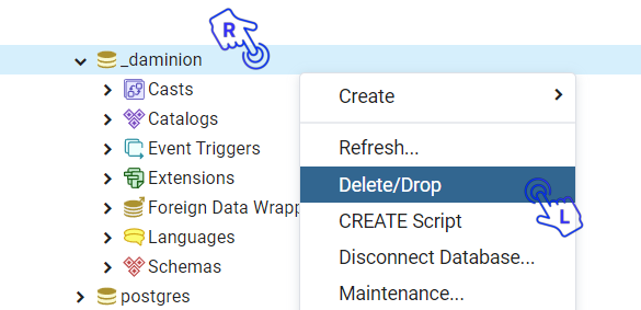

Make sure that Daminion Server is stopped and follow these steps:
  5. Connect to the Servers and expand PostgreSQL12.
  6. Locate the “_daminion” database, right-click on it select “Delete/Drop”.
  7. Follow steps 6-14 from the troubleshooting instructions above.

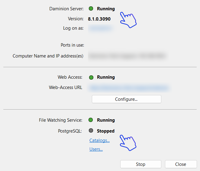

PostgreSQL 12 is not recognized as running by Daminion Server
If the PostgreSQL indicator on the Daminion Server Administration panel is grey while the PostgreSQL service is running in Windows Services, it indicates a password mismatch between the “postgres” database user password entered during installation and the password specified in the Daminion Server “catalog.config” file.

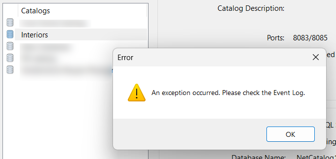

If your Daminion Server Service is running but PostgreSQL is displayed as not running, follow these steps:

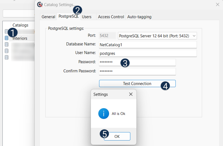

    • – Open Daminion Server Administration panel and navigate to Catalogs.
    • – Double-click on the catalog to open its Settings.
    • – In the following Exception window, click OK. Catalog Settings will open.
    • – Navigate to the PostgreSQL tab and enter the password that you used during the installation of PostgreSQL12.
    • – Click on “Test Connection” to verify that the connection to the database can be established.
    • – If you have multiple catalogs, repeat the same with each catalog.
