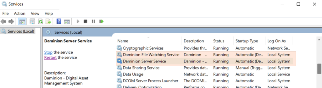

Daminion Server will be installed on your server computer and run as a Windows Service.

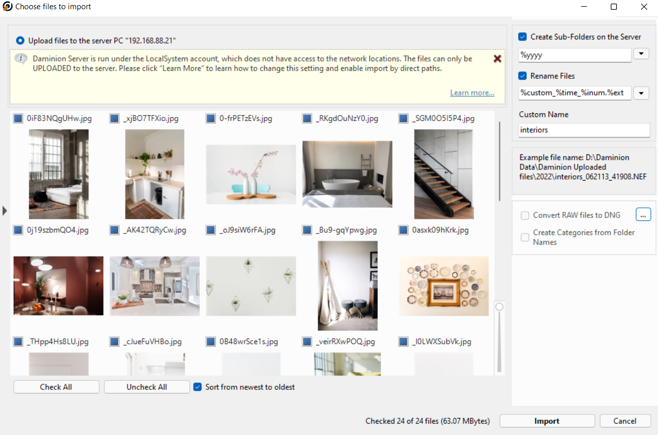

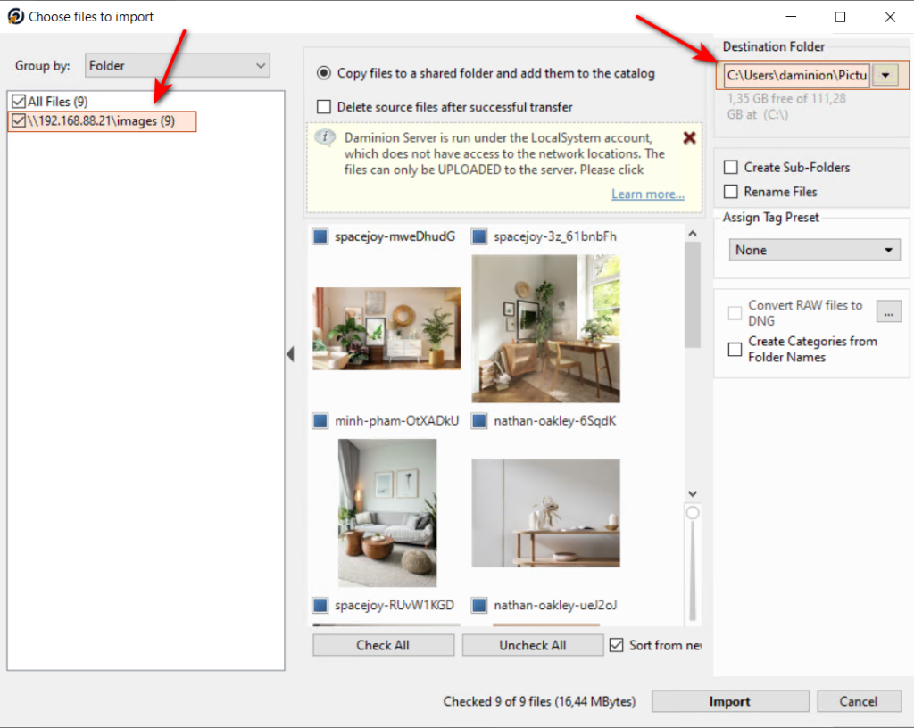

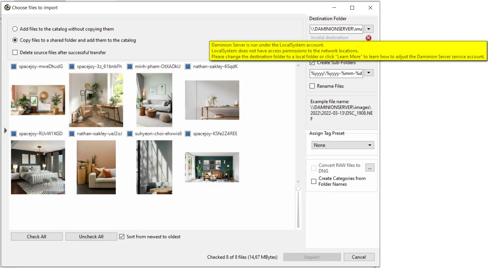

By default, Daminion Server Service and Daminion File Watching Service are run as LocalSystem. It is recommended that you change it especially if the original files are stored in the network locations and should not be uploaded (relocated) to the Daminion Server computer.
LocalSystem does not have access permissions to the network locations which results in certain import restrictions when Daminion Server Service is run as LocalSystem.
  • The files can be imported by direct links only if the files are located in local folders on the server computer (the “Import files without copying them” option)

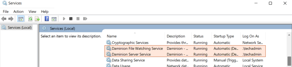

To remove these restrictions and enable the import by network paths, the logon user of the Daminion Server Service should be changed.
To do this, open Windows Services and follow the below steps:
  2. Right click > Preferences
If your computers are a part of a workgroup make sure to create a new user account on the Daminion Server computer. This user account should have the same credentials (username and password) as the account that has full access permissions to the original media files on the file server.
For example, the files are stored in ”\MediaServerFilesProjects” and can be accessed by the user “MediaAdmin” with the password “MediaO1F_52”. On the Daminion Server computer, you need to create a new user with the same credentials.
If the original media files are located on a NAS, the user created on the Daminion Server computer should have the name and password as an admin user on the NAS!
Check out how to create a new user here.

To verify that Daminion Server Service logon user is configured correctly, open your shared catalog and try to import one file from the network storage using the option “Add files to the catalog without  copying them”.
If the import finishes without any error messages, you can keep on importing other files and folders.
