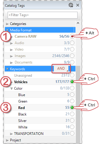

The numbers to the right of the entries in the Tags Panel indicate how many items have been assigned to the particular tag.
TagList_ENG
Click the circles next to the numbers to view all the items in the browser that use the same tag.
You can extend your selection by holding down the Ctrl key and clicking multiple tags. If you hold down the Alt key and click, the circles go red, and the selected tags are excluded from the search.
CatalogPanel_ENG
In our example, we have chosen to view all items that use the keywords Vehicles and Red, while explicitly excluding Camera RAW files.
The word AND in the red box means that items being searched for must use both Keyword tags, Vehicles AND Red. Select OR instead of AND to view items that use just one OR both tags.
