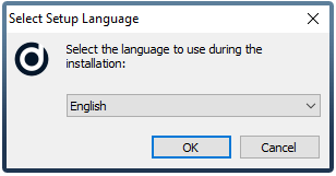

On the first screen, select an installation language. Daminion suggests the language used by your operating system, but if you prefer to use a different language, change it here. Otherwise just click OK to proceed. Note that the interface language can be changed in Daminion any time after installation.
Setup_Server_01_ENG

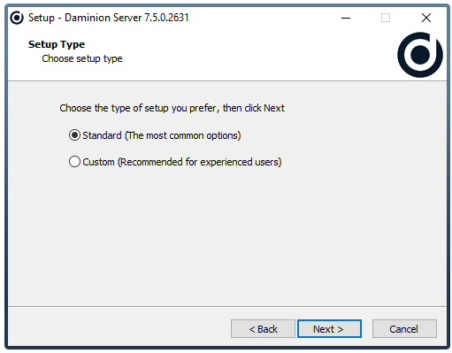

After confirming the welcome screen and accepting the license agreement, choose between either the Standard or Custom setup. If you choose Custom, you must then specify which Port numbers should be used  by the Postgres database. You can easily change this parameter later in the Admin Panel (launched automatically at the end of the setup process), so feel free to proceed with the Standard installation.
Setup_Server_04_ENG
3

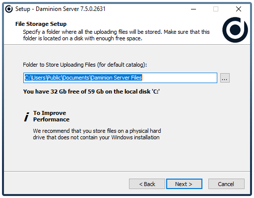

Select a folder path for your uploaded files.
You can type a folder path of your own or leave the default. But please remember to select a shared path so that other users can access the folder. If you choose a local path, other users may not be able to see files in the destination folder.
Note: We recommend that you use a different physical hard drive than the one your Windows OS is installed on. This not only allows you to access your files much faster, but also makes it easier to back up uploaded files. And finally, if you start running out of disc space, you can easily replace this hard drive with a bigger one without affecting your windows installation!
Please read the article Selecting the Right Storage Scheme for helpful information on choosing the right storage theme for your personal needs.
Setup_Server_08_ENG

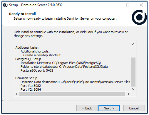

After you have chosen whether or not to add the program to the Start Menu and to create a desktop icon, Daminion is ready to install the program files. Click Next to continue.
Setup_Server_11_ENG
7
Setup will now install and configure the Daminion Server and create the default catalog.
Setup_Server_12_ENG

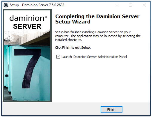

Finally, click Finish.
Setup_Server_13_ENG
