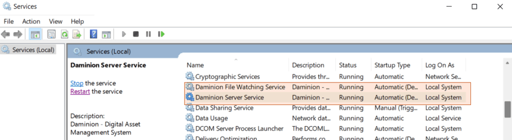

By default, Daminion Server Service and Daminion File Watching Service are run as LocalSystem. It is recommended that you change it especially if the original files are stored in the network locations and should not be uploaded (relocated) to the Daminion Server computer.

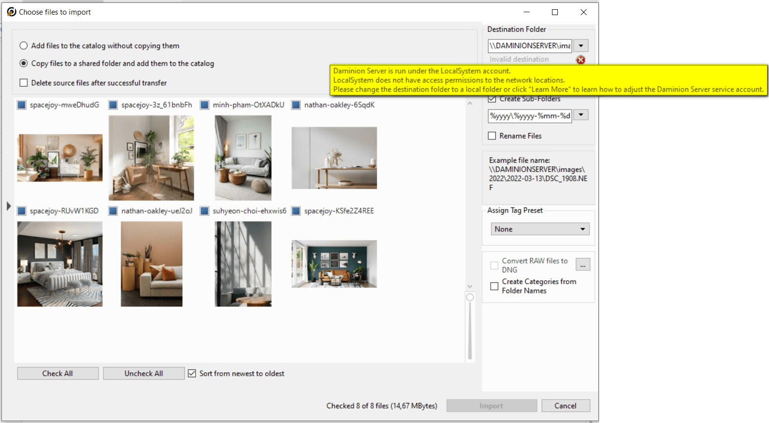

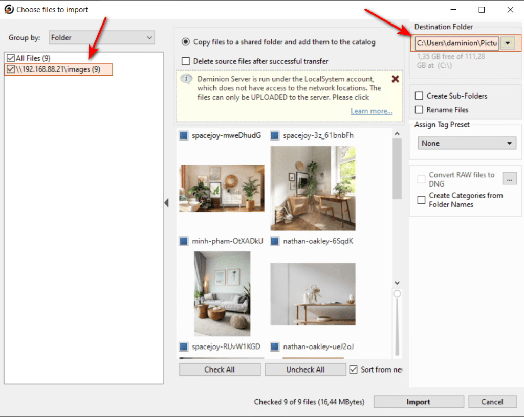

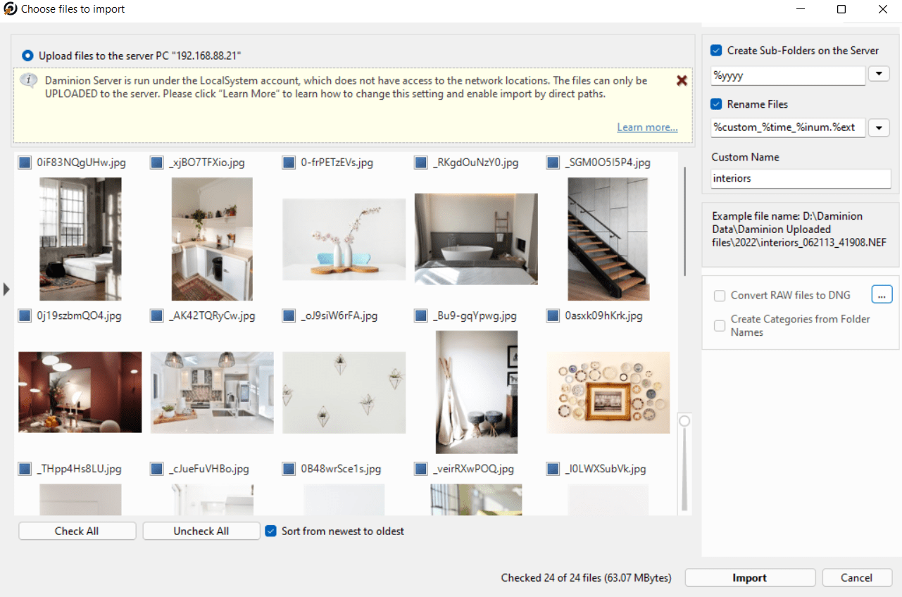

LocalSystem does not have access permissions to the network locations which results in certain import restrictions when Daminion Server Service is run as LocalSystem.
  • The files can be imported by direct links only if the files are located in local folders on the server computer (the “Import files without copying them” option)

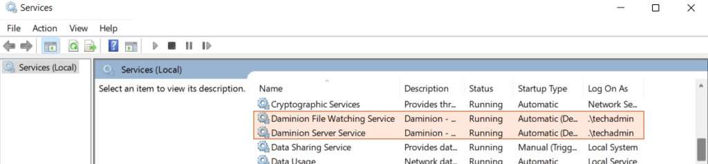

To do this, open Windows Services and follow the below steps:
  2. Right click > Preferences
